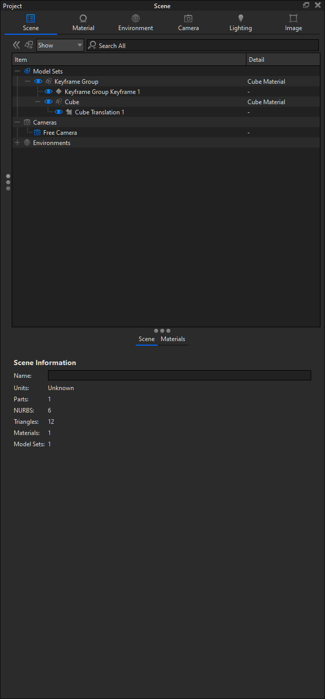

Normally KS does not allow you to use both animations on the same object.
So I found a way that looks like this. Create a group and insert the object you want to animate as a keyframe and animate the group. Then you can animate the object itself with transformation. Or you can switch: Transform to the group, keyframe to object. Whichever scenario works best for you.
